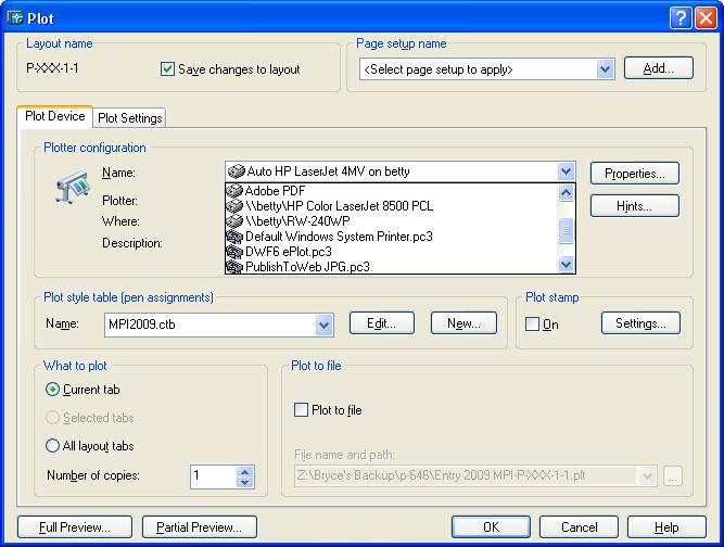

[updated before posting]: I've just tried the options\files thing mentioned in one of the threads I linked and I thought I had gotten everything mapped to the "root" computer, but it's still popping up with that dumb warning window whenever anyone but myself tries to print from their computer. I'm not sure that our printers & plotter are properly set-up at the moment. Here's a jpeg screenshot of the plot window, showing how our plotters show up when you hit print:

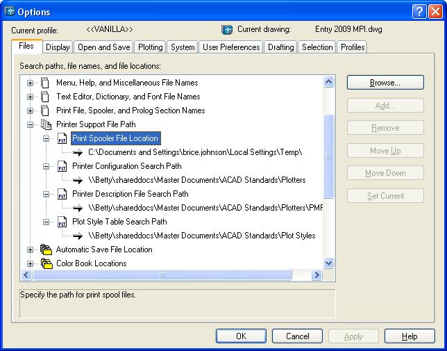

Also, I think it might be the "Print Spooler File Location" under Options\Files. Right now it's pointing at my temp folder, but there's like 1000 things in there and I don't know what I'm looking for. Here's a jpeg screenshot of my Options\Files with the print spooler pointing at my C: drive, and the others pointing at the new network drive.

Okay, I guess I just don't know how to do that. I copied the entire contents of the temp file (c:\Documents and Settings\my.name\Local Settings\temp) on my hard drive onto the network drive and pointed the "Print Spooler File location" in Options\Files at it (shown in 2nd pic above), but it's still not working. It's obvious that I've ventured OT into printer territory, hopefully the mods will let it slide and someone who knows how to do this can walk me through the process. I don't really know anything about network administration or printers.

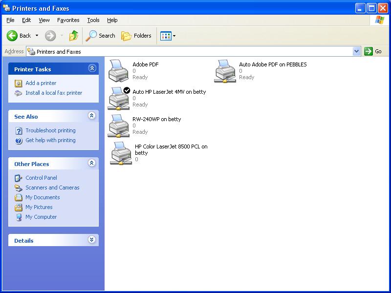

When we go to print, we just select the printer in the drop down menu in CAD, as shown in the first pic above (called "...4MV on betty", betty being the network computer I'm trying to map everything to). We don't ever select those pc3 options that are shown in the menu. Should we? Is there any special procedure for setting them up? Do they just run in the background? The printers and plotters we use show up the same in Control Panel (inserted below) as they do in the CAD drop down menu, and the pc3 files are not there (they're in both C:\Program Files\etc,etc and also \user.name\Application Data\etc,etc). I have a sinking feeling I'm missing something obvious but I am sadly clueless.
Do I just need to have these pc3 files and printers in one location on the network drive I'm pointing at, or does each individual computer need them? And if so, since they exist apparently in multiple locations, which ones do I keep and make sure are all the same?

Verify the printer names are identical on all computers. AutocAD is looking for the name of the printer "4MV on betty". If there is an extra space in the name or at the end of the name AutoCAD will give you a warning.
Indeed, profcad nailed it. In addition to needing to modify each individual profile (since they're user specific at each machine not file specific over entire network) so that the printer items all point to the same network drive instead of locally, I also had to tweak all the printer names. I looked at my printers in Control Panel (see above) and compared to those on other machines. Verdict, totally hosed. Basically, we're a shop full of not too terribly computer savvy users, so anytime there was a printer issue they did creative loads of drivers. We had "printer on barney on bambam on betty" etc etc. (Yes, the owner is apparently a fan of The Flinstones). I just uninstalled all the drivers at a different computer, loaded fresh from the wizard, and made sure they had the same network path name as those used in the drawing.

2-In individual user profile, point the (4) items under plotter to the same location on a shared drive (you may have to create these, just copy from your computer).
3-On each other separate individual user's computer, set up profile the same (Options\Files) so that they point to same place on shared drive.
4-MOST IMPORTANTLY (and not so obviously to me anyway), go to each individual computer's control panel and make sure that all the printers have the EXACT SAME network name. I found uninstalling and then reinstalling to be most effective since I did them all at the same time.
