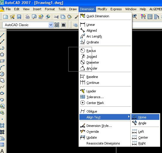

Sometimes, Marco, if you can't find the bitmap images you want by searching the application’s directories, you have to use the "brute force" method. See the attached image.
I confess to being a button guy, because my keyboard cannot spell. Usually I make my own, but when one exists somewhere that I want to use, I "borrow" it. For example: Because I do a lot of filtering, I lifted the "Filter By Selection" icon (second from the left) from Microsoft Access. I got it by opening an Access file and taking a screenshot of the program, then using an image editor, cropped down to the button at 16x16 pixels, and saved it as a .bmp file. MS Paint will work just fine for this. Save it to your custom button bitmap directory, then visit the customize interface to assign the bitmap to a command or macro.
Steve
