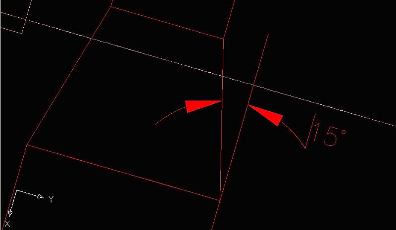

I got this lisp off of cadtutor it was written by ASMI. Is there a way to edit it to make transitions from one pipe size to another at 15 degrees?
CREATES DOUBLE LINE DUCT WITH CAPS AND CORNERS, NO TRANSITIONS

Hi Chelsea1307,
What do you mean by transition @ 15 degrees?

Calculate what you need to get degree and length.
I want the change from one to the other to be at the same degree all the time, whether it happens in 3 inches or 3 feet doesnt matter as long as it progresses at 15 degrees ive attached an image to show what im talking about. Other then that the lisp works great for double line duct drawing ive looked at the other ones posted on this site and this one works the best for me except for that.
