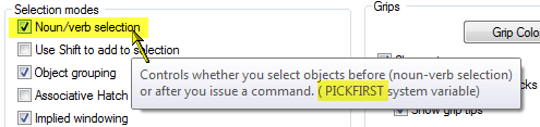

b.muqlueen Posted March 12, 2008 Posted March 12, 2008 Just out of nowhere just now, my delete key stopped function in autocad. It work fine in windows. any ideas? Quote
smorales02 Posted March 12, 2008 Posted March 12, 2008 in your "options" under the "selection tab" make sure you have "noun/verb selction" checked. We had a problem like this at my old job and If I remember correctly that was the issue. Let me know if it helps Quote
chrisdarmanin Posted March 12, 2008 Posted March 12, 2008 pickfirst variable... its listed in the FAQ Quote
frotico Posted December 12, 2012 Posted December 12, 2012 After a crash, my 'pickfirst' variable becames 0. After setting it up to 1, delete key restart working. Quote

emrecanp Posted May 6, 2014 Posted May 6, 2014 Although i have no idea how it happened, options => selection => "noun/verb selection" solution worked perfect for me. Thank you very much. Quote
rkmcswain Posted May 6, 2014 Posted May 6, 2014 Just to clarify... "The noun/verb selection" toggle in Options controls the PICKFIRST system variable. IOW, they are the same. Quote

brip131 Posted June 18, 2014 Posted June 18, 2014 I just ran into this issue today. Happened for no apparent reason. This post below from smorales02 was my solution as well. Thanks guys! in your "options" under the "selection tab" make sure you have "noun/verb selction" checked. We had a problem like this at my old job and If I remember correctly that was the issue. Let me know if it helps Quote
nestly Posted June 18, 2014 Posted June 18, 2014 I just ran into this issue today. Happened for no apparent reason. Escaping out of a Lisp routine is often the culprit. Quote
BIGAL Posted June 20, 2014 Posted June 20, 2014 Often find in the middle of deleting using the Del key it just stops working and have to press E then it works again Huh ? Quote
adamtoogood Posted July 28, 2014 Posted July 28, 2014 I have no idea how this happened. It seemed to just happen out of the blue but thank you for your help, it help to calm me down right away. in your "options" under the "selection tab" make sure you have "noun/verb selction" checked. We had a problem like this at my old job and If I remember correctly that was the issue. Let me know if it helps Quote
SLW210 Posted July 29, 2014 Posted July 29, 2014 Escaping out of a Lisp routine is often the culprit. Also some AutoCAD commands, Express Tools (LISPs) and Third Party add-ons. Quote
Pero Designs Posted December 16, 2014 Posted December 16, 2014 like many of the above comments, my CAD crashed yesterday and as a result the delete key on my keyboard has stopped functioning in CAD only. When you refer to the 'Selection TAB' and 'Options', where exactly am I to find theses tabs, I cannot locate them on my AutoCAD LT 2015 screen. Quote
nestly Posted December 16, 2014 Posted December 16, 2014 Type OPTIONS at the command line, or right-click on the Command Line and pick "Options" from the right-click menu. Quote
