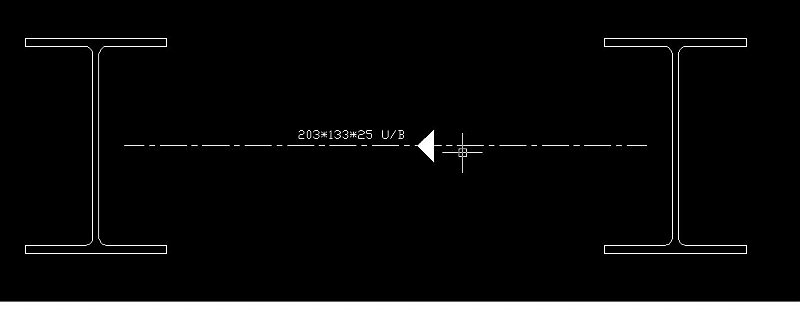

I am using AutoCad LT 09. I am looking for a way to draw a line from point to point that has a "set back" at each end of the line. The line would look and act like a leader on a dimension but the set back would be at both ends. This is a type of line structural engineers use to draw framing plans where the beams are shown as single lines but stop just short of the line, i.e. beam, they frame into.
In other words, the end of the line would still be at the nodes to which it was drawn but the line would appear to be a bit short at each end.

Sounds like you would have been better off with a steel detailing program.
Similar to this.
(Just an example because you cant post images)
Similar to this.
Yes that is exactly what I am looking for. Now, how do I do it?

To be perfectly honest, you would need a lisp file for this. To create a dynamic block wouldn't really work at all.
