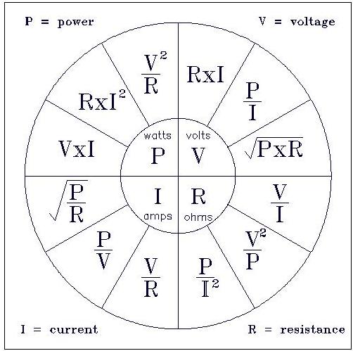

Here they are:
P = VxI  OR (setq P (* V I))
P = RxI² OR (setq P (* (* I I) R))
   V²
P = –    OR (setq P (/ (* V V) R))
   R
V = RxI  OR (setq V (* R I))
   P
V = –    OR (setq V (/ P I))
   I
    ___
V = √PxR OR (setq V (sqrt (* P R)))
   V
R = –    OR (setq R (/ V I))
   I
   V²
R = –    OR (setq R (/ (* V V) P))
   P
   P
R = –    OR (setq R (/ P (* I I)))
   I²
   V
I = –    OR (setq I (/ V R))
   R
   P
I = –    OR (setq I (/ P V))
   V
   _
  √P
I = -    OR (setq I (sqrt (/ P R)))
   R
Interestingly enough, I was browsing my C book earlier today and I saw something called polymorphism. I never knew that computer code could be so inherently flexible. Is that a property of the code, or the compiler? Seeing all those equations, it reminded me, and made me wonder.. would it be possible to write a polymorphic function in LISP, or does LISP not have that ability?
Freerefill.
Are you referring to this: eg V = √PxR
I was just using the windows character map to show which formula belongs to which lisp calculation. Its just for reference.
Here are just the lisp calcs for less confusion.

That is basically what I plan to do.
I am using this for an Ohms Law Calculator.
You would pick the operation you want to perform and supply the two knowns and have the third returned. I am going to do this with a DCL and vector image to confirm the proper calcs to the user.
Obviously I am not using these calcs as you see displayed. They will be arranged in their respected functions. Earlier I got hung up with two of the calcs and was looking for help, But I decided to figure it out for myself.

;;  supply two of the three arguments to get the third
(defun OhmsLawPVR (P V R)
 (cond
   ((not P) (/ (* V V) R))
   ((not V) (sqrt (* P R)))
   ((not R) (/ (* V V) P))
(defun OhmsLawPVI (P V I)
 (cond
   ((not P) (* V I))
   ((not V) (/ P I))
   ((not I) (/ P V))
(defun OhmsLawVIR (V R I)
 (cond
   ((not V) (* R I))
   ((not R) (/ V I))
   ((not I) (/ V R))
(defun OhmsLawPIR (P I R)
 (cond
   ((not P) (* (* I I) R))
   ((not R) (/ P (* I I)))
   ((not I) (sqrt (/ P R)))
;;  solve for S given 2 of the remaining 3 variables
;; S = string "P" "V" "R" "I"
;;  should have error checking
(defun OhmsLaw? (S P V R I)
 (setq S (strcase S))
 (cond
   ((= S "P")                ; return Power/Watts
    (cond
      ((not R) (* V I))
      ((not V) (* (* I I) R))
      ((not I) (/ (* V V) R))
   ((= S "V")                ; return Volts/EMF
    (cond
      ((not P) (* R I))
      ((not R) (/ P I))
      ((not I) (sqrt (* P R)))
   ((= S "R")                ; return Resistance/Ohms
    (cond
      ((not P) (/ V I))
      ((not I) (/ (* V V) P))
      ((not V) (/ P (* I I)))
   ((= S "I")                ; return Inductance/Amps
    (cond
      ((not P) (/ V R))
      ((not R) (/ P V))
      ((not V) (sqrt (/ P R)))
WOW!
That is excellent CAB. Although I had tested the ones I had posted and found that they work OK, This is much more thorough. I seem to things in a simple format and build around it, But yours would make the coding much shorter.
Thank You
CAB,
Should this
    (cond
      ((not P) (* R I))
      ((not R) (/ P I))
      ((not [color=red]V[/color]) (sqrt (* P R)))
Be this?
    (cond
      ((not P) (* R I))
      ((not R) (/ P I))
      ((not [color=red]I[/color]) (sqrt (* P R)))
Yes, you are correct.
As I typed them up ASAP and went off to tennis & just posted them when I returned, too tired to test them. I'm cleaned up and looking for dinner so enjoy. I'll fix the code in the post per your catch.
Thanks.:)
