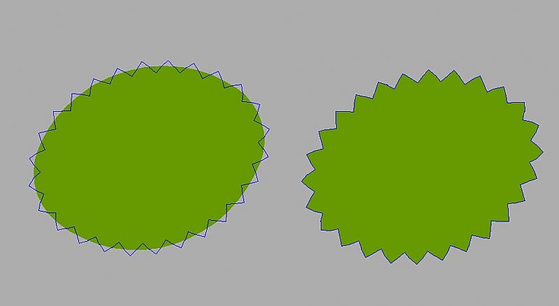

Please can someone tell me if it's possibe to do a solid hatch to an object which was drawn with a "zig zag" line type and get it to fill to the edges of the wavey line, rather than just to the centre line?

This is the problem I'm getting:
Is there a way to get it to hatch 'to the teeth' of the line, not the centre line?
Alex
If you really really want to hatch into the teeth, here is a way, but not very simple. First explode the line with the Lisp LNEXP, then join up all the individual zigs, and then you can hatch into the teeth. I would not like to do this more than once :shock:

The line segments of the zig-zag line are not continuous when the line is curved. So when exploded there are lots of zig segments and lots of zag segments with gaps between. I tried the multiple option of Pedit with the fuzz set to 0.1, and it did not do a complete join and I reverted to dragging ends around and then joining. That is why I said I would not want to do it many times :cry:

What I decided to go for in the end was the revision cloud tool, which gave the kind of effect I wanted, and it filled to the 'arcs'.
