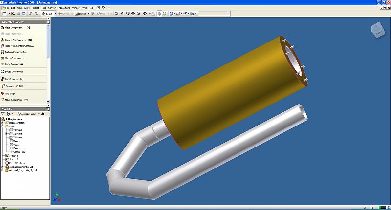

I am woundering how to weld in Autodesk Inventor...
When i see the guides the have a "weld" tab in their three... I dont...
This is what i have so far, and i would like to veld right after the tube comes out of the chamber...

when you first create a new file where you select your .ipt or .iam etc.. there are tabs at the top that let you choose metric, english etc.
As for weldments. At the top you should have a Convert menu and thats how you convert it to a weldment. They you will have to define all your welds. Your best bet will be to look through the help file and if there is a specific question about it then post back here. There is too much information to go through it all.
