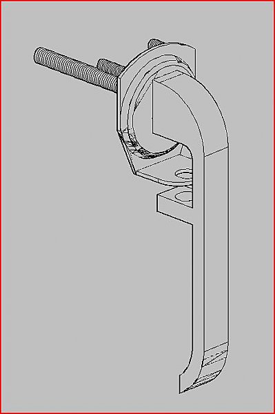

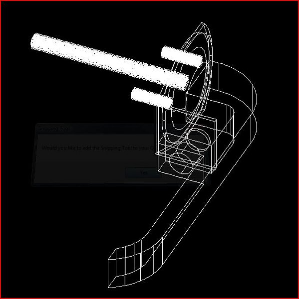

MWeabs Posted June 9, 2009 Posted June 9, 2009 Hi all, new to the forum and loving all the knowledge. I was looking around for an answer to my dilemma and apologize if the solution is on here already. Anyway, I am modeling a handle for a project and I used standard modeling commands (extrude polylines, subtract, union, revolve, etc.) and the 2D wireframe looks right, but when I do the 3D hidden it gets all out of whack. CAn anyone shed some light on why this is happening? Thanks in advance. Quote

MWeabs Posted June 9, 2009 Author Posted June 9, 2009 Thanks for the tip, David. I adjusted both settings but it does not seem to change anything. Am I missing something? Quote

MWeabs Posted June 10, 2009 Author Posted June 10, 2009 Yes I tried REGEN and no real difference. Also, I adjusted the FACETRES and then redid the model and I still get the jagged lines. I'd attach the file, but I can't get it below 500kb Quote
