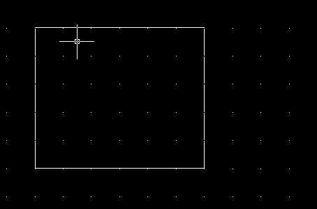

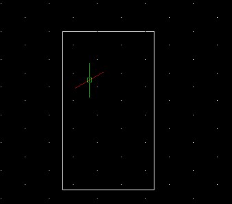

two snapshots of the drawing window. one in standard and one in isometric. they are both the same. well apart from the grid and curser
You have snap activated. Turn it off.
And while you're at it, unless you change to an iso grid there is no reason to have a grid showing.
You are confusing 2D isometric drawing with creating 3D objects and viewing them in an iso view. The only way to see your 3d object in an iso view is to use the view command, or use 3DORBIT or 3DFORBIT. It has always been this way in AutoCAD.
