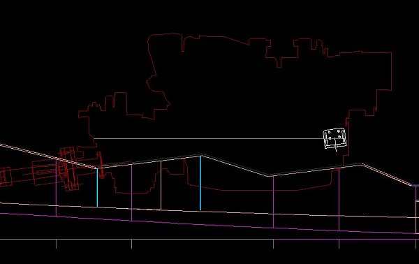

Matho Posted March 20, 2008 Posted March 20, 2008 Hi, Just wondering if I can get a boundary from the outside of an object. I have a 2D drawing of an engine+gearbox as a block and the need the outline. Regards Matho Quote
PS_Port Posted March 20, 2008 Posted March 20, 2008 You could try REGION but you have to select the boundary... another way would be to hatch the area with RETAIN BOUNDARY on, creating a polyline or region boundary, just by selecting an internal point. Quote
Guest Alan Cullen Posted March 20, 2008 Posted March 20, 2008 G'day, Matho, I think the command is BOUNDARY. Quote
azzro10 Posted March 20, 2008 Posted March 20, 2008 theres probably a better way than this but anyway, draw a rectangle around your engine gear box drawing size doesnt matter as long as its bigger than your drawing then use the command "BPOLY" in the dialog select pick ponit n pick a point in between the rectangle n your drawing then select ok you should now have a poly line around the outline of you engine n gear box Quote
PS_Port Posted March 20, 2008 Posted March 20, 2008 Why have I always got to do things the long way , matho the command is BOUNDARY, (Alan is right again ) I'm just glad I didn't start trying to write a Routine that acad already has a command for & has had for along time... Quote
Matho Posted March 20, 2008 Author Posted March 20, 2008 I know the boundary command " bo " but doesn't that only work when you click in the interal part on the object? As you can see the engine is quite detailed internally and it should look the one on the right I've only been drafting for 6 months and i'm still a noob. thanks for you replys Quote
azzro10 Posted March 20, 2008 Posted March 20, 2008 thats why i said to draw a rectangle around it first n then wen u use the BOUNDARY or BPOLY command select in between ur drawing n the rectangle altho u would think there would be a way to select the outer boudary any1 know? Quote
PS_Port Posted March 20, 2008 Posted March 20, 2008 Matho, what azzro is getting at , is that `BOUNDARY' or `BPOLY' also detects islands (the inner bit).. although going on my previous posts what do I know Quote
Matho Posted March 20, 2008 Author Posted March 20, 2008 Thanks mate, trying that now.... autocad has frozen up but i'll be patient and see what the out come is. Quote
Guest Alan Cullen Posted March 20, 2008 Posted March 20, 2008 Azzro, I'm not sure that will work. I think it may produce a boundary on the "inside" of the rectangle. But then again, I just tested it, and it looks like it will work. Doing it your way produces two boundaries (using BOUNDARY command). One to the inside of the rectangle, and one to the outside of the motor. Matho, go with Azzro's suggestion. Quote
azzro10 Posted March 20, 2008 Posted March 20, 2008 yeh i thought that two at first Allan but gave it a go n what do u know she worked still think there must be a way to us BOUNDARY or a similar command on the external of objects tho Quote
Matho Posted March 20, 2008 Author Posted March 20, 2008 i've tried BO with a rectangle twice and auto cad keeps on freezes up. Any other thoughts. Maybe my Computer is to slow that command?! Quote
Guest Alan Cullen Posted March 20, 2008 Posted March 20, 2008 Okay, a couple of things to try first. Purge the drawing, then do an AUDIT on the drawing. Then even purge again. Then try the BOUNDARY command. See if that helps. You may also need to close down any other applications you have running, to free up some RAM. Quote
azzro10 Posted March 20, 2008 Posted March 20, 2008 even save it to a new file in put everything on layer 0 n purge out the rest, every little bit counts Quote
Matho Posted March 20, 2008 Author Posted March 20, 2008 I'm go to have to delete the inside lines via edit block in place. The drawing is too detailed and complex but i'll keep the drawing a rectangle trick in mind for next time. thanks Quote
SLW210 Posted March 20, 2008 Posted March 20, 2008 Why not _WBLOCK your Engine to a new drawing (or Copy/Paste if you like) and try to do the boundary command there. Then delete everything but the profile and insert it as a block? Quote
