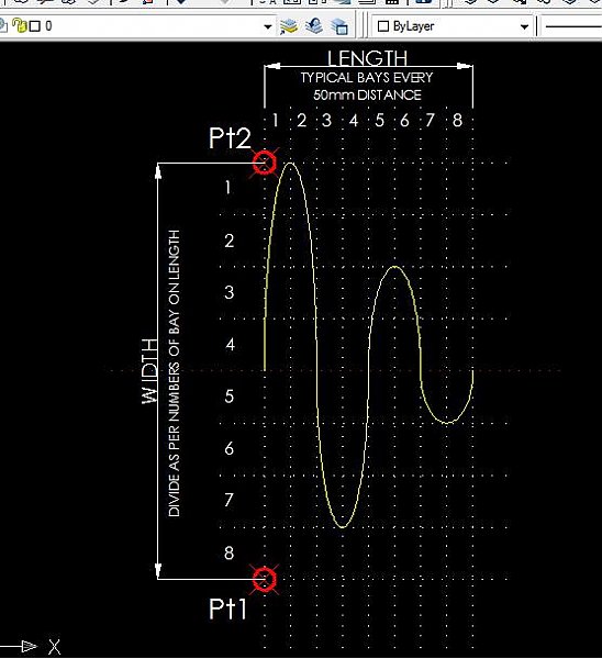

Please to help me to have a Lisp route of Waves like shown on attached image,
On the length to be assigned numbers of bays and must be 50mm on distance every bays, then the width will be getting the distance by pt1 to pt2 to divide the distance according to the number of bays of length,:unsure:
The wave is like a sound measurement that like High to low frequency the graph dot lines will be the imaginarily path for the wave distance to show what it will be, Kindly if you have a route to create a wave please to have also, Thanks all
Not sure if this will help, it is very much incomplete but I toyed around with it a bit. It has an option for damped harmonic motion, perhaps you could change the variables therein to suit your needs.
That said, it's a lot of fun. I've also got code for a sphere and hyperbolic paraboloid, if you're interested.
The code itself is -not- complex, it is actually quite basic (nested repeats) so you can modify it easily with a core knowledge of LISP.
It's been a while so I'm not sure if you can directly set the frequency... but maybe it'll get the ball rolling at least.
That said, it's a lot of fun :3 Try creating your own functions for other formulae!
Hope it helps. ^^
