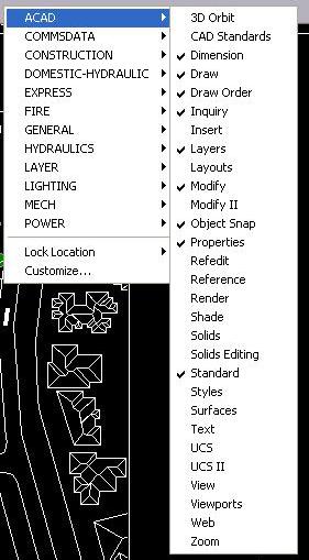

hi thanks for the quick responce.
yep thought that to.
ive got this -

i wonder if this was a problem when migrating settings for the upgrade.
as i had layers II for 2009 version. i rely on it alot to. the isolate layers and unisolate is very handy when processing architectuals for backgrounds to our drawings.
i might try to reinstall autocad, but dont migrate and see if that fixes it.
ok guys found out the problem.
the acad file i was loading was an old one.
loaded the new one and all fixed!!
