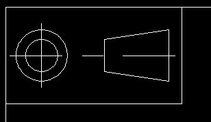

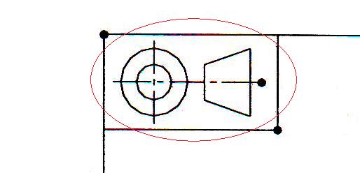

I want my centre line to look like the attached drawing.
However mine in the cad screenshot attached are different. I've tried loading all centre line types and still nothing comes out as correct as this. Is this another scale issue?
Thanks
Yeah, looks like you either need to try chaning the LTSCALE variable, or manually change the scale within the properties of the line.

Change the ltscale to a lower value from the current value.
At the cmd line type >LTSCALE> press enter Set new value XXX enter the new value and press enter.
If you play with different values you can choose the best looking one for your Dwg.
