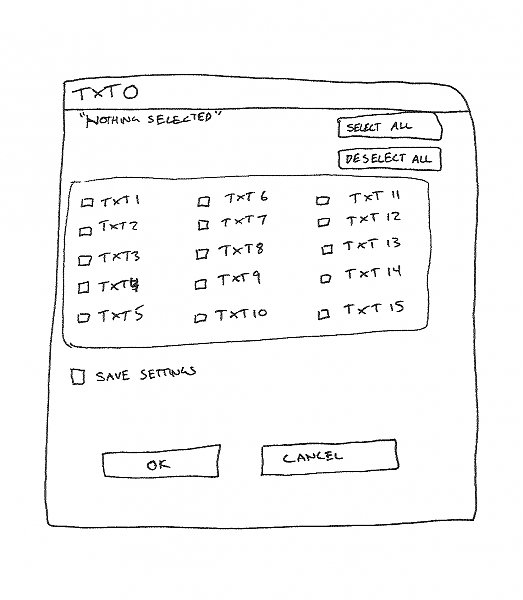

i've been trying on and off for a couple of days now to get a dcl layout the way i want it - unfortunately i dont know anything about dcl and i'm going off the autodesk help guide.
I've attached a sketch image of the layout i want and was wondering if anyone would be able to help me with it
Thanks heaps
You will have to excuse to quick hand drawing
Are the button check boxes or radio buttons?
How's this??

Tim thanks heaps mate - i didnt expect anyone to reply to that honestly let alone finsih it in one go
Anyways thanks mate and i'll send you the lisp and final Dcl so that you have a copy
I'll be adding a few more toggle boxes to that
Basically all it will do is create a legend by inserting blocks that contain symbols and text and sorting the down the page depending which ones are selected.
Cheers mate

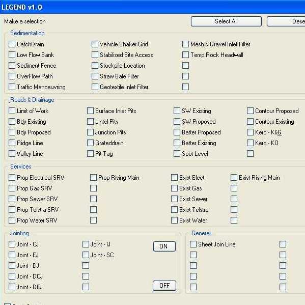

One more question how do you insert a image in a dialogue box??
The "image" has to be a slide created in AutoCAD or a vector graphic created by code.
I used a vector image in the dialog above to create a seperator line. If you are just getting into dcl I would recommend looking ito OpenDCL instead of plan DCL
http://opendcl.com/wordpress/
It has alot more to offer.
i'm still editing it and the moment but you will get the gist
Could you guide me through inserting a slide in this DCL?
I have to define the image within the lisp don't I - What code do you use to define a image tile within the Dcl?
I haven't really started defining the function within the lisp yet - but basically i want to be able to do is have each toggle box insert a block that is made up of a simple symbol and description to be within a legend.(these blocks obviously within acad search path)
So once desired toggles are selected and user selects ok the user select an initial insertion point and the the lisp would create a list of selected toggles and run through the list and insert the first block at the insertion point but then cycle through the list and insert each block (-2.5(Y)) units below the previously inserted block until the list is complete thus creating the legend.
Tim maybe you could help me also with the list process aswell??
Hope i didnt just confuse you.
Cheers

Could someone show me an example of how to have the select all and select none buttons work? Google and AfraLisp are failing me.
What are you selecting? Radio buttons? Check Boxes? Items in a list box?
Sorry about the picture size - i had to crop it less that 600 X 600 to insert it
Cheers
If you are using the dialog for inserting legends, You would be better off with a popup list.
I was using check boxes, but switched to list_box (mulitple selections)
Here is some code that you can use:
The caller:
(SELECT_ALL \"tile_name\" (length listlength))
The Function:
;;; ------------ SELECT ALL ITEMS IN LISTBOX
(defun SELECT_ALL (Key Count / StartCount Value Count)
(setq StartCount 0)
(setq Value "0")
(repeat (1- Count)
	(setq Value (strcat Value (itoa (setq StartCount (1+ StartCount))) " "))
(set_tile Key Value)
This code will deselect the content in the listbox
(set_tile "tile_name" "")
You will want to make sure that you set the list variable to nil when you deselect the contents.
HTH
Thank you, that solved my problem directly. I appreciate the help!
