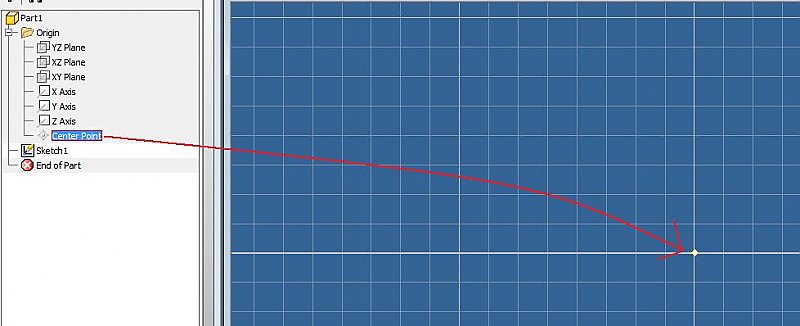

cmjay83 Posted June 23, 2009 Posted June 23, 2009 Hi I am very new to inventor I am using 2010 at the minute. I have a problem. I need to draw a tube approx 910mm high X 89o/d. I have go to put 7 holes in it straight through, I am not sure how to do this. I can do it on a square or a rectangular face but it won't let me do it on this because it's round? Appreciate any reply Cheers Quote

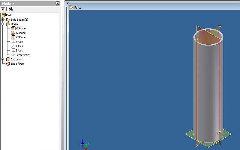

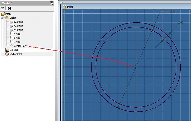

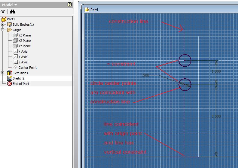

shift1313 Posted June 24, 2009 Posted June 24, 2009 Here are a couple screen shots for you. The first one shows you the origin point. This point is (0,0,0) and where your yz, xz and xy planes intersect. The second picture shows you my tube cross section drawn at the center point. Notice both circles are fully constrained, coincident with the center point and given a Diameter(and offset for inner circle). Third picture shows you that tube extruded and the 3 planes with Visibility on. you can see my planes bisect the tube(yz and xz) and the tube rests on the xy plane. This allows you to use these planes and not need to create a reference plane. The 4th pic might be a little hard to read but its the two holes sketched on one of those planes and dimmensioned. Quote
