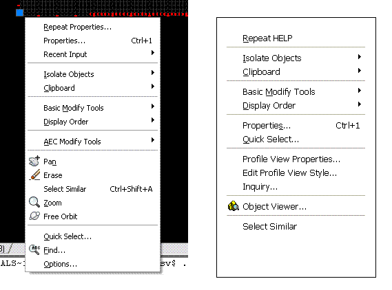

I am working in 2009 Civil 3D, but I don't get the same right click menu (when I click on items), as my co-workers....
While working on the profile in my drawing (for example), I "click on the profile" (see the grips) and right click, I get a different menu. They make the same moves, in their own projects, they get a different menu. See attached:
The menu on the left, is what I get when I right click on a profile
The menu on the right, is the menu everybody else gets....

I don't get "Profile View Properties" and "Edit Profile View Style"

Type in CLICKFIRST and set the value to "1"
