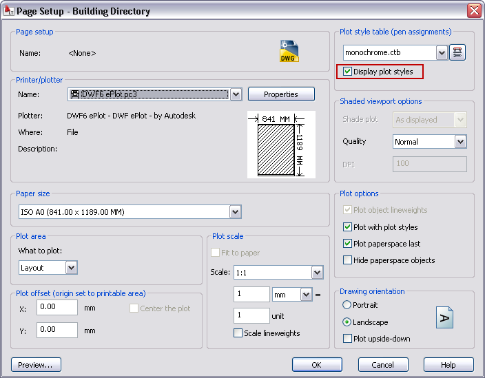

tzframpton Posted January 3, 2012 Posted January 3, 2012 Don't forget the Display Plot Styles checkbox in the PAGESETUP dialog. This can come in handy too. Quote
