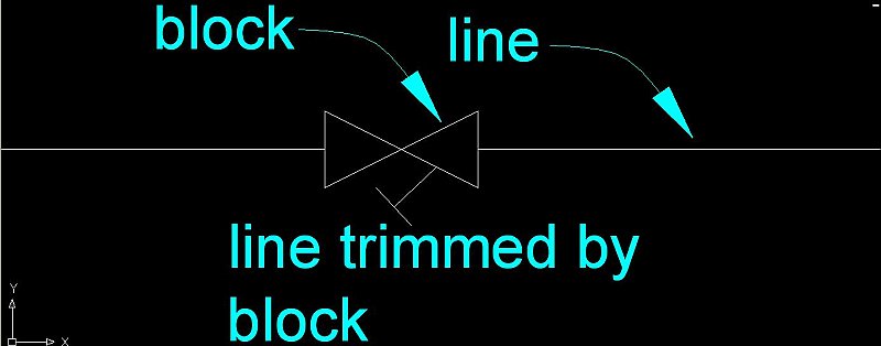

so in a perfect world, when running this command i would select a line, select an angle and the block would insert with the line the i inserted it on broken around it, alas this is not a perfect world. I continue to get an error saying 1.00000 is not a command (that number changes sometimes) any ideas as to why? or a better way to write it?
(defun c:BDV ()
(setq scl (getvar "dimscale" ))
(setq dis (* scl 0.0703))
(setq player (getvar "clayer"))
(setq lne (entsel "n\Select line" ))(terpri)
(setq name (cdr (assoc 8 (entget (car lne)))))
(setvar "clayer" name)
(setq pnt (getpoint "\nPick insertion point:" ))(terpri)
(setq a (getangle "\nAngle?:" pnt ))(terpri)
(setq ang ( * a 57.3))
(setq pt1 (polar pnt a dis))
(setq pt2 (polar pnt (- a pi) dis))
(command "insert" "BDV" pnt scl scl ang)
(command "break" lne "f" pt1 pt2 )
(setvar "clayer" player)

this is what the command line shows, after the 48.00000 it exits out of the command but no block has been inserted. and bdv is in a folder in the search path
Command: bdv
Select a Line:
Pick Insertion Point:
>Enter block name or [?]: BDV
Units: Unitless Conversion: 0'-1"
Specify insertion point or [basepoint/Scale/X/Y/Z/Rotate]:
Command: 48.000000
