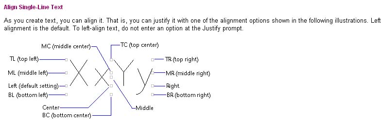

Thank you for the quick response. I know what the letters stand for, and I know typical justification choices like center centers the text line on line, and left justify and right justify, but don't see a difference when I try MC. I'm curious as to when you would need this. I might be missing out on something that might be helpful.

Thanks, but you lost me on that one. I still don't se a difference between this MC and the old fashioned justify, c, enter.

Ah, this explains it. So you can pin point where the middle of the text string will be. Thanks for the illustration. I haven't gotten into the help tool yet, just got this 2009LT 2 days ago.
