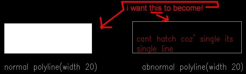

Can anyone figure what is this all about. If I make a single LINE with a thickness(width of 20) then the output view is normal rectangular shape, what should i fix to make it as normal line with a normal thickness??

Sounds like you are using Pline (polyline) that has a width of something other than "0". Try typing PLINEWID at the command line and setting it to zero. Does that solve your problem?

What i mean when i'm making a single polyline with a widht of 20, it turns it into rectungular.. just like in the second image..

Reset PLINEWID to "0". You'll end up with a line that has no width and thus it won't look like a rectangle. That should solve your problem.
If you have a bunch of lines that have width already then use the Pedit command with the Multiple option. Select all the polylines and reset the width to "0".
Perhaps FILLMODE has got changed? It needs to be set at 1 for solid lines.

If FILLMODE is set to 0 then a polyline with a width other than zero will take on the appearance of a rectangle.
That' is the command what i'm searching for.. Thank you! you're nice!
