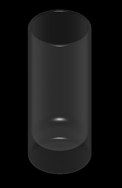

This is a glass rendered vase I drew a little while ago when I first started drawing in 3D. I haven't played around with lighting, the drawing is rendered just using the AutoCAD render tools.
Your materials library should offer some sort of customizing options as well; I seem to recall 'transparency' being one of them.
I just used 'Glass' as the material. As far as I recall 'transparency' controls whether or not you can see objects underneith a raster image with on or off being the options.
