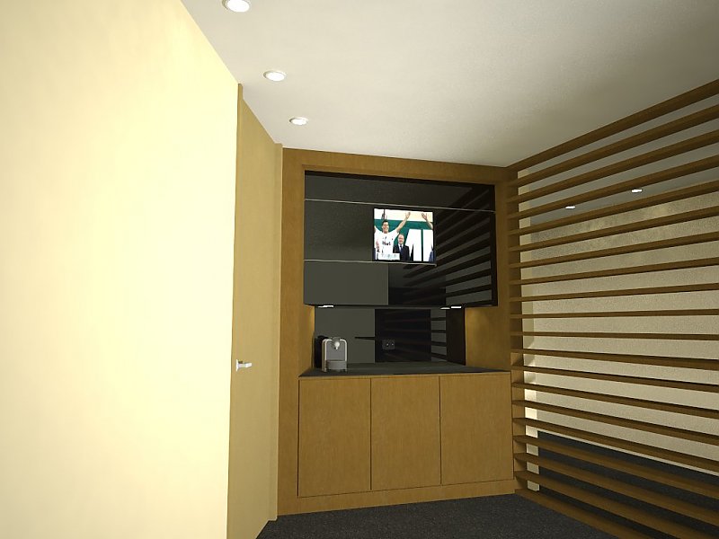

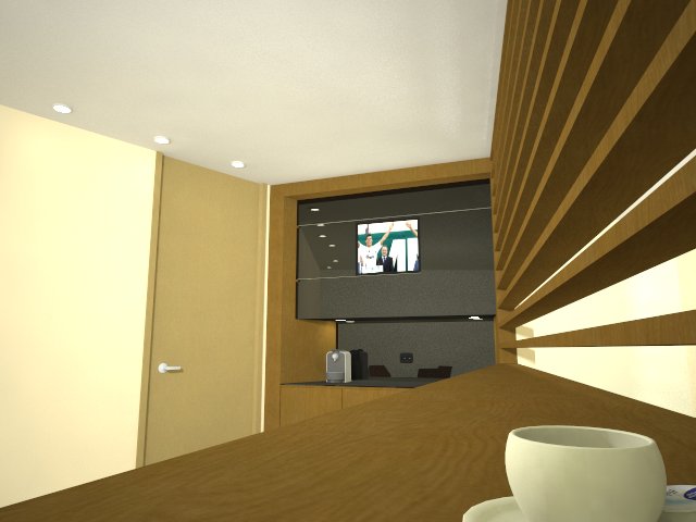

michaeloureiro Posted July 8, 2009 Posted July 8, 2009 check out the vray pluggin for sketchup, here´s a sample of my latest rendering rendered with it Quote
michaeloureiro Posted July 8, 2009 Posted July 8, 2009 I didn´t configure any materials on the renderings, just lighting. You can get better results if you set the material properties with vray. Quote
Cad64 Posted July 9, 2009 Posted July 9, 2009 Michael, you might want to take a look at that door. I've never seen a door that went floor to ceiling like that. If that door opens into the room, it's going to hit those little ceiling lights. You might also want to work on your materials. The cup and saucer in the first image looks very dull. They should be shiny and reflective. The saucer looks faceted too. You might want to smooth it out. Quote
michaeloureiro Posted July 10, 2009 Posted July 10, 2009 cad 64, The door opens into the next room and won´t hit the spotlights, like i said in the post, the materials in the render aren´t vray configured. I just wanted to point out to warren architecture that he can get a bit more quality using vray without having to waste alot of time. Thanks for the tip anyways! I´ll be posting more images for your critiques:) Quote
