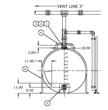

Adobe Pro also has a snapshot tool. Great for copy to clipboard and paste into cad, email, or any document. Image below is a "snapshot" from a *.pdf.
