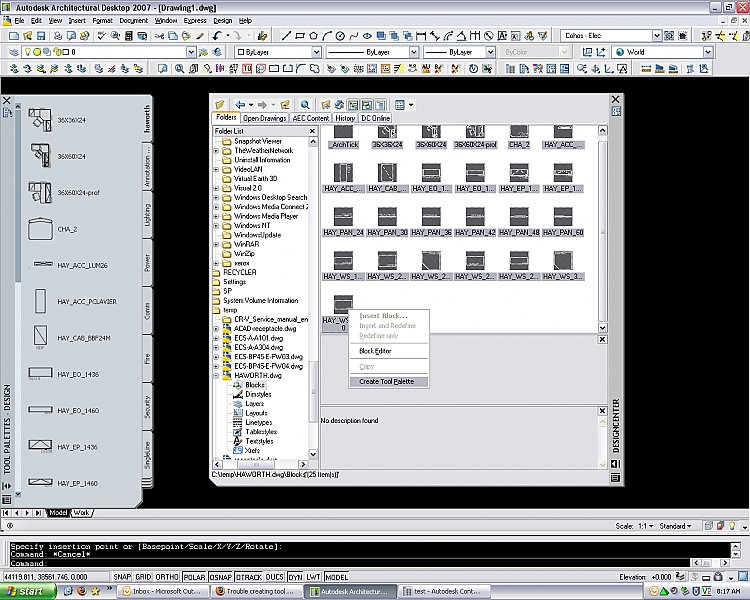

- Open designcenter
- under folder, browse to your haworth.dwg
- click on blocks just under your dwg
- It will load for a second or so, and you should see all your blocks in the right window
- click on the first block on the window, then hold down Shift and select all the blocks in the right window
- After all the blocks are selected, right-click and go down to "Create Tool Palette".
- Now it will ask you to enter a new name "TAB" for the tool palette. Enter HAWORTH and it's done.
- It automatically created a "HAWORTH" tab with all the blocks inside.

I've attached a screenshot.
