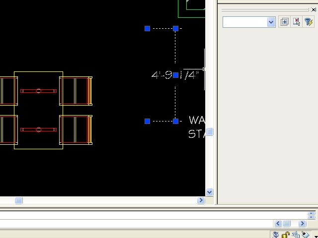

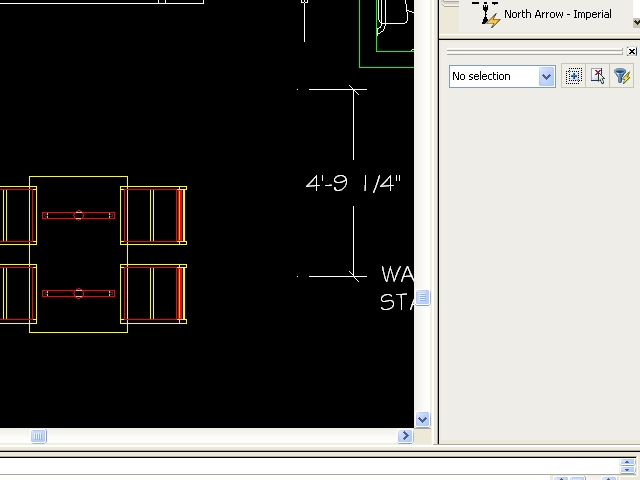

Yet another problem. :cry: So I found how to retrieve my missing Properties Tool Bar that went missing using the "CUI" command (that rocks by the way), but sadly it is not showing anything now. I have it docked on the right side of my workspace and when I have nothing selected it says "No selection" in the drop down menu, with the 3 selection icons next to it. That is normal or at least I think it is. What is NOT normal is when I select any object, line or dimension the only thing that changes with the entire toolbar is the drop down box goes blank. none of the potions come up at all. Can you wonderful folks help out a nOOb again?!!! Thanks!
PS - I have included pics of the toolbar with nothing selected and then with the dimension line selected.
Two possibilities come to mind...
Is Pickfirst set to 1?
Have you run a registry cleaner lately? If so you may need to do a repair of the installation
Yep - a registry "cleaner" is usually to blame for this....

I also have had this same problem.
It was the McAfee registry cleaner causing the problem.
You will have to do a repair of the AutoCAD installation to correct the problem.
Make sure you turn of the registry clearners options.
Well the Repair Install worked. Just fyi ... cleaning the registry did not work for me. Thank you so much for the help everyone!
