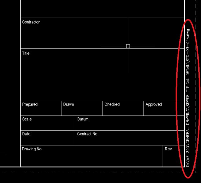

anaskattayil Posted July 10, 2014 Posted July 10, 2014 I had a drawing with file name , date & time ( Field Rtext)in the right side corner of drawing sheet. Unfortunately its erased from me. please can you help me for making new one... or any lisp for that???? Quote

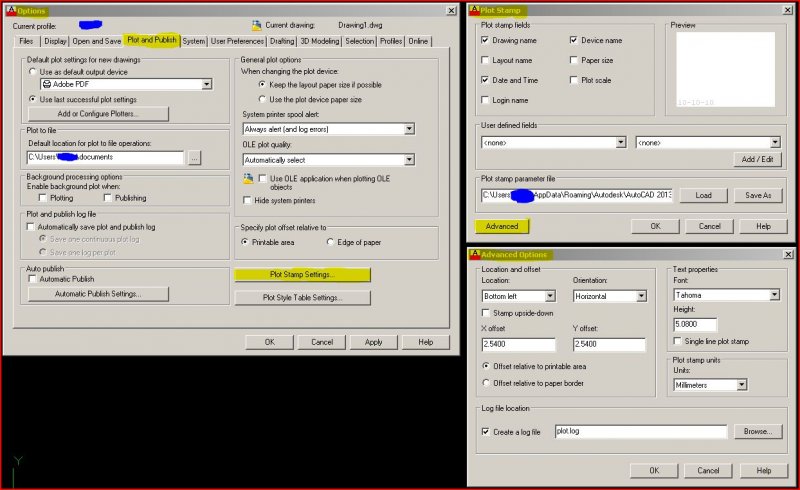

Dadgad Posted July 10, 2014 Posted July 10, 2014 I had a drawing with file name , date & time ( Field Rtext)in the right side corner of drawing sheet. Unfortunately its erased from me. please can you help me for making new one... or any lisp for that???? Have you tried using the OOPS command? If that doesn't work (seriously, try the OOPS command first), then refer to the screenshot where you can learn how to replace what you seem to have erased or misplaced. Quote
anaskattayil Posted July 10, 2014 Posted July 10, 2014 Please check the attached drawing. i need like this. I think its from FIELD-RTEXT. Please help me.. Quote
Dadgad Posted July 10, 2014 Posted July 10, 2014 Try doing a PLOTPREVIEW, and you may find that it will be generated, when it is plotted, as I suspect that it is a PLOT STAMP, rather than a simple field which has been inserted. Quote
