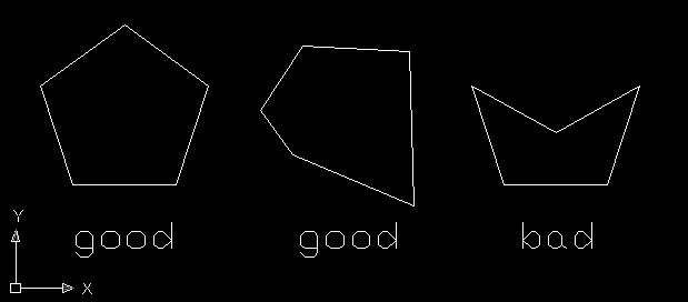

Say you wanted to determine if a point was within any regular or semi-irregular polygon. Well it's hard to do, yeah? There's probably a lot of math involved, and whilst a circle is easy (radius) as is a rectangle (upper and lower axial bounds), there's so much more that should be considered, so many more shapes that we want to see if a point is within or not! And by "we" I mean "me" :mrgreen:
So I wrote this up. This will do just that: determine if a point is within any regular (id est, all sides and internal angles being equal to one another.. like using the "polygon" command) or semi-irregular (stretched and skewed a bit, but the area of the bounding box of the polygon must equal the area of the polygon itself) polygons. I even did you one further and wrote a function to get the 3D vertices of a polyline and return them as a usable list.

And to give you an idea of what I mean by "regular and semi-irregular", here's a convenient image. And, sorry about attaching the file.. I can't access my Photobucket at the moment. I'll clean it up later.
Also, how you create the polygon is important. You can't, say, have 2 vertices overlapping (not that you ever should, but still). I'm sure there are some other things that would screw it up. Basically, the input for the inPol function should have a form similar to:
(list (list 0 0 0) (list 1 0 0) (list 0 1 0))
which, you'll note, are simply the three vertices of an isosceles triangle.
You'll note that there's nothing funny in there, no extra vertices that are the same and whatnot. I'm sure there's a way to write a check into the function, but it's not meant to determine if a point is within an area bounded by an AutoCAD polyline, it's made to determine if a point is within a polygon defined by the inputted vertices.
