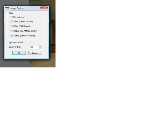

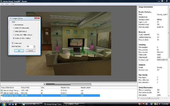

i just did a quick test render...i made a rectangle and extruded it...then i hit render and did a save as tif w/ alpha (you need to specificaly choose the 32 bit w/ alpha option)...opened in photshop and the alpha was there...

I did for you with acad 2008.This is true? Ok or not pls reply me.

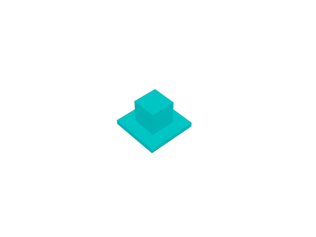

No, that's not it. If I start a new drawing, draw a box and render it to 32bit TIFF, I don't get an alpha channel.
Could you do the same and then attach the DWG and TIFF files here so that I can pinpoint the problem?
Here we are, but I had to convert the TIF in PSD. TIFs are not accepted here. I checked for the alpha channel it is there!
Cube.dwg
Cube.psd
OK, I opened your PSD and the alpha channel is there. I open the DWG and render it to 32bit TIFF, open in Photoshop and - no alpha channel. :cry:
