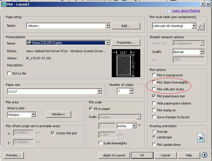

To print a readable file I unchecked "Plot with plot styles" and then unchecked "Plot object lineweights" when that option appeared. Is this going to be something that I have to do for every file that I want to print?

The easiest solution will be to find colorcad.ctb, do a search on your computer to see if it pops up or check with a co worker to see if they have it and get a copy from them
