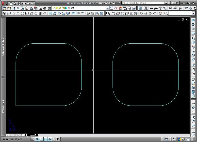

GE13579 Posted July 15, 2009 Posted July 15, 2009 Below I've replicated the problem- the left hand rectangle is drawn with snaps but not closed, the right hand rectangle is the same PL copied over then PEDITed and CLOSEd. :wink: Quote
GE13579 Posted July 15, 2009 Posted July 15, 2009 Yep just looked over your file close the PL and you should be ok.. Quote
