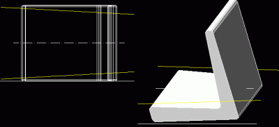

I am also trying to do a model of a complicated chair.
wwwdotlightmypumpdotcom/my_chair2dotdwg
I created this by first making a polyline of the edge of the chair ( if you are sitting, the edge coresponding to your left side) and then extruding it. I then fiilleted (a fishy term) the edges. Now the problem is how to make the back of the seat narrower than the front. Here is a picture of the chair for more clarity:
wwwdotlightmypumpdotcom/my_chair-picdotjpg
Any suggestions? It's amazing how even a simple chair can be complicated to model correclty in 3D.

About the chair
In the top view add an axis line and two yellow lines to delimit the shape. Use the SLICE command to get rid of the margins. When AutoCAD prompts you for 3 points to define the slicing plane, pick the two ends of a yellow line and enter @0,0,1 for the third point. Repeat the slice for the other side
You will have to remake the fillets
