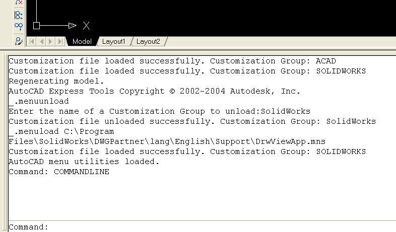

My AutoCAD 2008 is not loading my lisp programs correctly, and I'm trying to figure out why.
I notice that this screenshot is what comes up when I start AutoCAD from a fresh boot.
How can I keep AutoCAD from loading the Solidworks info?
I checked the properties of the AutoCAD 2008 icon on my desktop and the target is "Acad.exe". Is there something inside the acad.exe that is loading the Solidworks info?

All that tells me is that a partial menu named SOLIDWORKS is being loaded, unloaded, then reloaded
Have you tried removing this partial menu manually from the parent menu, then restarting? If so, and it keeps coming back, then there could be an ARX or some other startup code causing this to happen.
See: http://cadpanacea.com/node/159 for more info on startup code.
I'm trying to get rid of it, but it keeps coming back.
From AutoCAD, I type CUI at the command prompt. There is a subfolder under "Partial CUI Files" named "SOLIDWORKS". I right-click on "SOLIDWORKS" and choose "Unload partial CUI file".
The next time I restart AutoCAD, it's back again. I'm still researching, but will appreciate any help.
