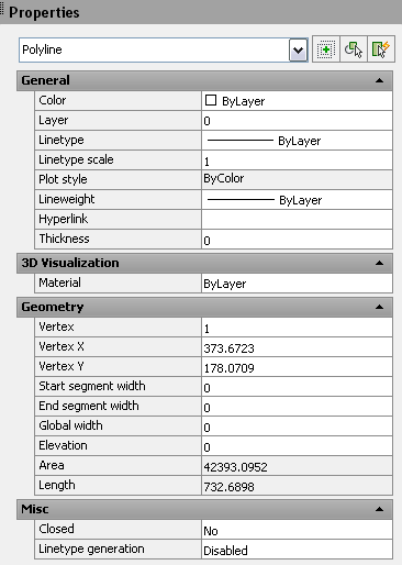

lpseifert Posted July 16, 2009 Posted July 16, 2009 Here's one, I'm sure there are plenty more if you search... look for PolyArea.lsp http://www.turvill.com/t2/free_stuff/index.htm BTW... if you need the area of 1 polyline, select it and look in Properties Quote

DVDM Posted July 17, 2009 Posted July 17, 2009 In Autocad 2010 it's simply part of the Properties in the Geometry section. It has Area and Length. This isn't available in Autocad 2007? Quote
