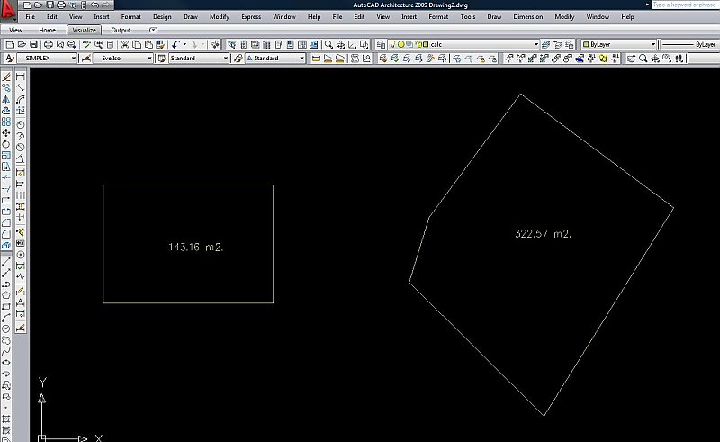

Is it possible to make it write the area inside each closed polyline ? :P
If its possible within 1 hour from posting id be great. :P (deadlines)
This Lisp routine works fine for me.
After loaded, typ LA and pick internal point.
Area2 writes the area in squared meters.
Area3 writes the area in squared feet.
//Tobias
Area2.lsp
Area3.lsp

You are so right Crazy J.
But ezealor asked "Is it possible to make it write the area inside each closed polyline ?"
And that is what these lisp routines does.:wink:
See the picture.
//Tobias

Great Lee!
Much easier. No messing around with layers an regions as the others that I had.
I know you are busy, but can you add so it writes the area in squared meters?
Im using this often so it would be great! If you got the time.....:)
//Tobias
Hey Tobias,
It will currently write it in whatever units you have set - not sure what conversion factor to use.
But assuming you are using 'mm'
(defun c:lta (/ *error* text ent pt)
 (vl-load-com)
