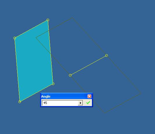

ive added a screen shot showing the selected work plane, the selected Zaxis and the Angle prompt.
