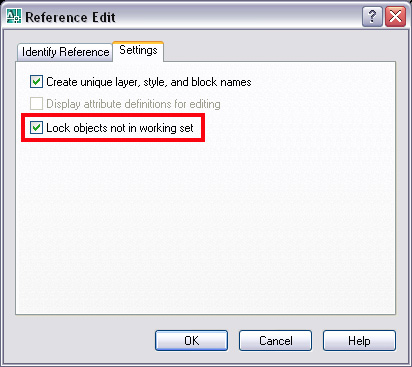

I have the next problem. Two computers. Autocad 2006 installed in both. When xrefing in one, I can only edit the entities within the xref or block in the working set. In the other, I can edit all entities in the drawing although they "are not" part of the working set since they appear in shaded colors.
I have not found any system variable that can help and all information I have found is related to add/remove entities from working set, but not about how to lock/unlock the rest of the drawing which is not part of the working set

In the "Reference Edit" dialog, go to the "Settings" tab and uncheck the "Lock objects not in working set" box.

A really late reply, but:
check to see if any layers were frozen, I had the same error. I had freezed a "noplot" layer before editing the xref and couldn't save the changes. I thawed all the layers and then edited the xref and it'd save my changes then.
