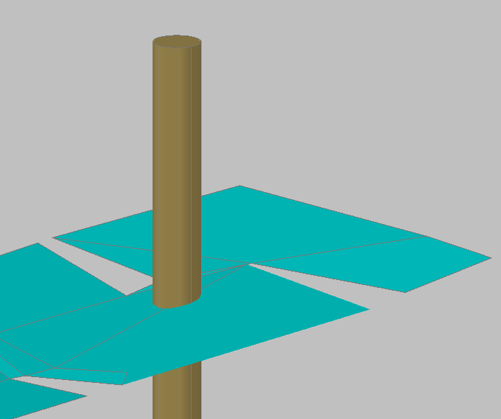

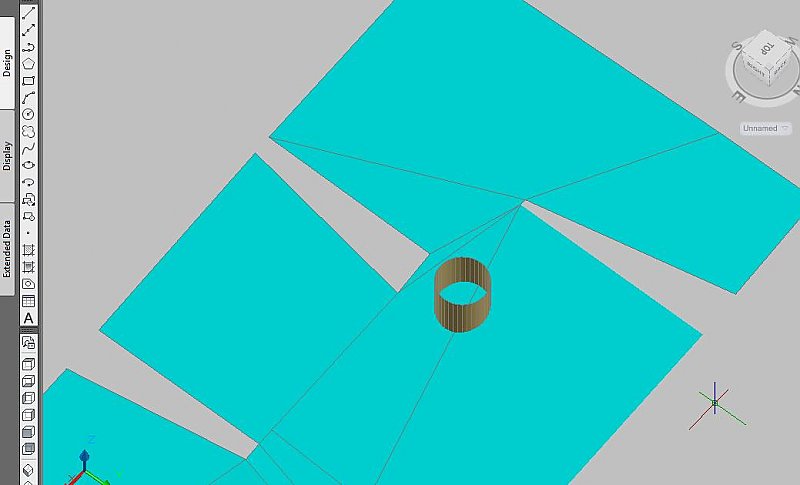

Im trying to create a circular hole in a not planar surface, but i dont know how to do this.
I attach the image.
Thank You

It looks like the cylinder you have made in not a solid object.
What you would need to do is create a circle and then use the extrude command to pass the circle through the surface. This will then turn the cylinder into a solid item. The next command you need to use would be subtract.
You will need to follow the instructions on the command line.
(you can also hit the F1 key while in the subtract command and a small demo will appear.)

I try to subtract the 3dface with the cylinder ... but autocad dont let me because it cant select the 3dface.
here is the code message:
"Command: subtract
Select solids, surfaces, and regions to subtract from ..
Select objects: 1 found
Select objects:
Select solids, surfaces, and regions to subtract ..
Select objects: Specify opposite corner: 1 found
Select objects:
No solids, surfaces, or regions selected.

Ive just noticed that you said the objects and non-planar.
You need to covert the shapes around the cylinder using the
convtosurface command. then use the subtract command.
I did it!!! :shock: You´re the Man!!
