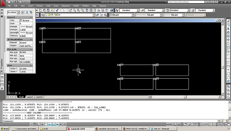

i have a script that draws a series of boxes using the basic structure
(setq pt1 (getpoint "\nClick the location of the top-left corner"))
(setq pt2 (list (+ width (car pt1)) (cadr pt1) 0.0))
(setq pt3 (list (+ width (car pt1)) (- (cadr pt1) height) 0.0))
(setq pt4 (list (car pt1) (- (cadr pt1) height) 0.0))
(command ".pline" pt1 pt2 pt3 pt4 "Close")
with subsequent boxes being based on the location of that start point, i've been having the points print to the command window as u can see in the attached screen shot and they are always correct. Basically the screen shot is of the same function run twice and in one it operates as expected and has 4 boxes with spacing between them, in the other it for some reason increases the size of some of the boxes and makes them all connect, its driving me nuts because its the EXACT SAME FUNCTION just executed at two different coordinates. Any ideas?
i've already tried
(command "line" pt1 pt2 pt3 pt4 "Close")
(command "line" pt1 pt2 pt3 pt4 pt1 "Close")
(command "line" pt1 pt2 pt3 pt4 pt1 "Cancel")
plus the mtext labels are based off the top left corner and they always appear in the right spots, so i'm 99.9% sure its not a problem with the numbers i'm feeding it
The OSNAP is causing the trouble. You will either need to use a VL method, or entmake method to create your LWPolyline, or add some code to turn off the OSNAPS.

Or, to mess with the OSNAPs:
Collect the original setting:
(setq oldOS (getvar "OSMODE"))
Turn them off
Either:
(setvar "OSMODE" 0)
or
(and (< 0 (getvar "OSMODE") 16384)
    (setvar "OSMODE" (+ 16384 (getvar "OSMODE"))))
Then make sure you return them to the original setting once finished:
(setvar "OSMODE" oldOS)
You may also need to make an error handler for the routine to allow for if the user hits Esc or Ctrl+C.
Hope this helps, but if you have any further questions, just ask.
Lee
as always, excellent work lee, i used the "osmode" var change as it was the simplest and it works like a charm :) :) :) so much headache gone :) lol
