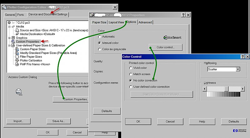

I am having problems printing colours in Autocad LT 2010 to an HP 130 NR large format printer. The colours on screen are a lot darker than the printed colours. Have tried various quality settings on the printer but always get very light colours. Problem only seems to be with the Autocad HP combination, other software seems ok.

I had this problem and it was not the ink but a setting in the plotter properties. In Custom properties, Options tab, Color Control button, set to No color correction.

Thanks for the suggestion. I have looked at the various tabs etc under custom properties and the HP 130 doesn't seem to have a no colour correction option. I have tried the colour calibration today and that makes no difference and prior to that tried various quality settings etc. It seems very strange that the colours are so far removed from those displayed in autocad.

See attached, this is where I find it for the HP1050C.
