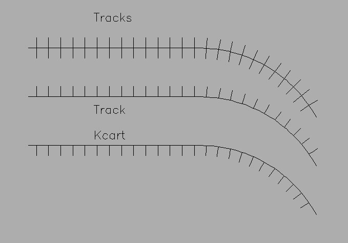

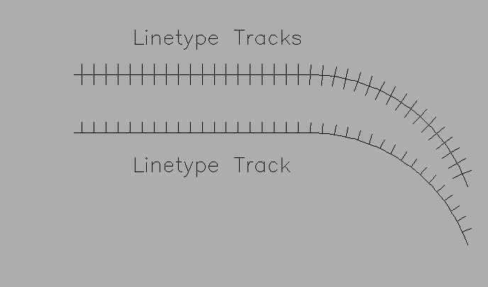

I explored the acad.lin, and found that Autocad already gives a Tracks linetype. You seem to want half this, so I editted the Tracks linetype to give a new linetype Track.
I reduced the scaling of the shape by half, and introduced a Y offset, and it looks fairly close to what you want.
*TRACKS,Tracks -|-|-|-|-|-|-|-|-|-|-|-|-|-|-|-|-|-|-|-|-|-|-|-|-
A,.15,[TRACK1,ltypeshp.shx,s=.25],.15
*TRACK,Track _|_|_|_|_|_|_|_|_|_|_|_|_|_
A,.15,[TRACK1,ltypeshp.shx,s=.125,y=.125],.15
Ask and ye shall receive. Is this AutoCAD forum just the best thing since sliced bread or what?
Of course, if the lines are on the wrong side of the line, then you have to have a backwards line with linetype Kcart, with a negative Y offset.
*TRACK,Track ┴┴┴┴┴┴┴┴┴┴┴┴┴
*KCART,Kcart ┬┬┬┬┬┬┬┬┬┬┬┬┬
A,.15,[TRACK1,ltypeshp.shx,s=.125,y=-.125],.15
Thanks for you help, this has worked out a treat!
