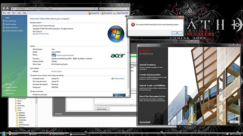

prototype Posted July 22, 2009 Posted July 22, 2009 im currently running vista64 sp1.. installation comes up to this.. http://i565.photobucket.com/albums/ss96/Paredes-Federizo/Untitled3.jpg anyone?? Quote

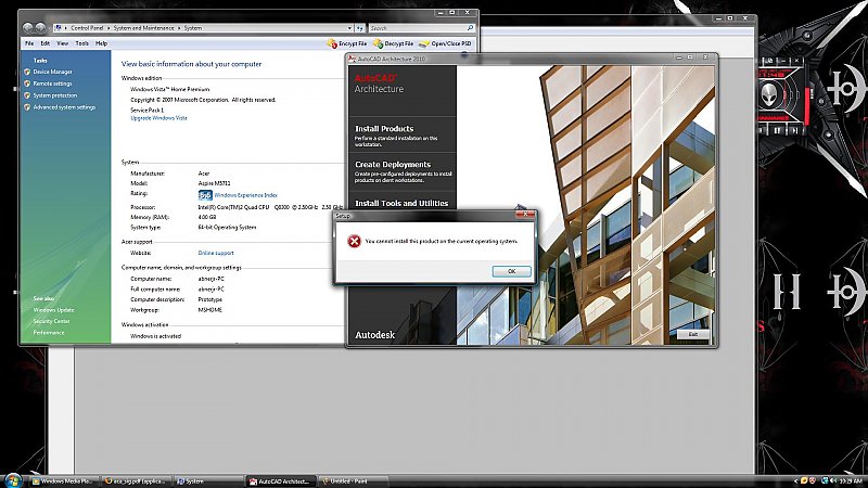

prototype Posted July 22, 2009 Author Posted July 22, 2009 sorry for that.. here it is.. on vista64 sp1 on vista64 sp1 dunno whats the prob.. Quote
prototype Posted July 22, 2009 Author Posted July 22, 2009 you cannot install this product on the current operating system... after clicking install products... my 3dsmax9 is working fine... and Revit Architecture 2009(exept the render library) Quote
Cad64 Posted July 22, 2009 Posted July 22, 2009 It looks like you're trying to install the 32 bit version of Autocad on a 64 bit operating system. Quote
CADMASTER1128 Posted July 22, 2009 Posted July 22, 2009 It looks like you're trying to install the 32 bit version of Autocad on a 64 bit operating system. I thought the same thing. But, I thought you were unable to do that? Quote
prototype Posted July 22, 2009 Author Posted July 22, 2009 autodesk have separate 32/64 installers?? Quote
Cad64 Posted July 22, 2009 Posted July 22, 2009 I thought the same thing. But, I thought you were unable to do that? Right, you can't. Hence the error message. Quote
CADMASTER1128 Posted July 22, 2009 Posted July 22, 2009 autodesk have separate 32/64 installers Thats Correct Quote
prototype Posted July 22, 2009 Author Posted July 22, 2009 my revit architecture 2009 seems to work... Quote
Cad64 Posted July 22, 2009 Posted July 22, 2009 Your Revit disk may have both the 32 and 64 bit installers on it, or it may just be the 64 bit version. When you purchased this software, didn't you specify that you needed the 64 bit versions? Or is this a new computer and you are now trying to load your software on it. If so, was your previous computer 32 bit? Quote
