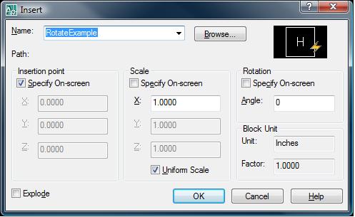

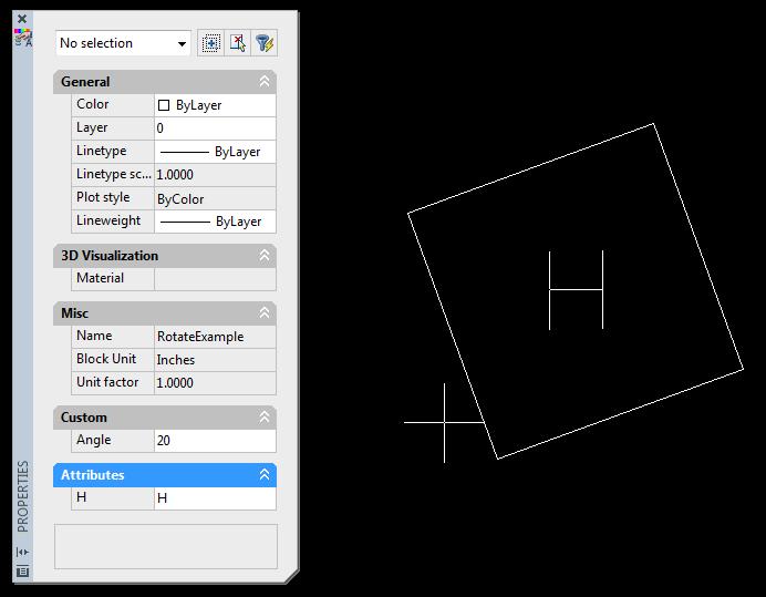

quamper Posted May 5, 2008 Posted May 5, 2008 When you go to insert the block skip the rotation option that you get in the insert dialog box. Instead you would set the rotation via the properties window (which can be set before you even place it) or simply use the grip to set it after being placed to whatever angle you desire. You can take a look at the dynamic block in the block editor to see how it's put together so you can create your own. rotateexample.dwg Quote

quamper Posted May 5, 2008 Posted May 5, 2008 You're not using the rotate command on that block are you? You have to use either the grip or the properties window (the angle field under custom, not the rotation field under misc) or else the text is going to rotate. If it's not that then I must be confused as to what you are wanting then. Because that should do it. Quote
