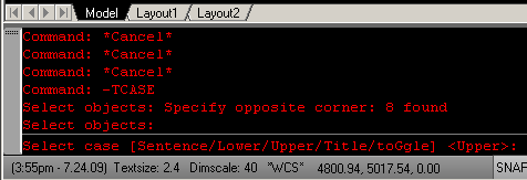

tcase has a commandline version of what you are working towards:
