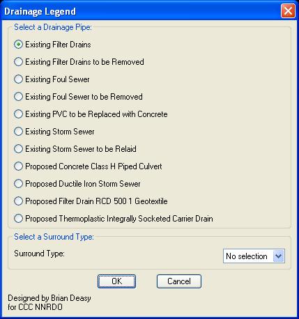

Ok Mr.woodman78,
I ran into some difficulty using two popup lists. I could get them to function, But not correctly. Rather than post nothing, I posted what you see below with combination radio_buttons and popup list. I am familar with this method and it works. If you are still sold on two popups, Maybe Lee_Mac can assist you here since he is well versed in this. The method shown here uses a Choose List Items function that was written by ASMI and which I had learned from Lee_Mac.
Try it out anyway to see if this does what you want. It is a starting point.
DCL
BLINS : dialog {
       label = "Drainage Legend";
       : row {
         : boxed_radio_column {
           label = "Select a Drainage Pipe:";
           : radio_button {
             label = "Existing Filter Drains";
             key = "DP01";
           : radio_button {
             label = "Existing Filter Drains to be Removed";
             key = "DP02";
           : radio_button {
             label = "Existing Foul Sewer";
             key = "DP03";
           : radio_button {
             label = "Existing Foul Sewer to be Removed";
             key = "DP04";
           : radio_button {
             label = "Existing PVC to be Replaced with Concrete";
             key = "DP05";
           : radio_button {
             label = "Existing Storm Sewer";
             key = "DP06";
           : radio_button {
             label = "Existing Storm Sewer to be Relaid";
             key = "DP07";
           : radio_button {
             label = "Proposed Concrete Class H Piped Culvert";
             key = "DP08";
           : radio_button {
             label = "Proposed Ductile Iron Storm Sewer";
             key = "DP09";
           : radio_button {
             label = "Proposed Filter Drain RCD 500 1 Geotextile";
             key = "DP10";
           : radio_button {
             label = "Proposed Thermoplastic Integrally Socketed Carrier Drain";
             key = "DP11";
       : row {
         : boxed_column {
           label = "Select a Surround Type:";
           : popup_list {
             key = "ST";
             label = "Surround Type:";
             edit_width = 12;
             alignment = right;
           : spacer {
             height = 0;
       : row {
         : column {
           ok_cancel;
           : paragraph {
             : text_part {
               label = "Designed by Brian Deasy";
             : text_part {
               label = "for CCC NNRDO";
LSP

 (ALERT (strcat "\nThe Drainage Pipe you selected was "DPIP"."
                "\nThe Surround Type you selected was "STYP"."))
woodman78,
There is a quirk with the above code. I am trying to contact Lee for some feedback. I will contact you later.
The Buzzard
Buzzard,
I made the follwoing changes to the output section of the code and it works a dream. Only one thing is whether it is possible to make the type be greyed out if no type is to be selected. Apart from that it is excellent. Thanks
; Output Function
(defun BLINS_OF ()
 (setq outp (strcat DPIP " " STYP))
 (command "_-insert" outp pause "1" "1" "0")
Use "mode_tile" to grey out tiles, and enable them :) 0 to enable, 1 to disable.
