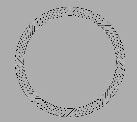

Not sure if this is possible, but here is my problem.
In a plan view drawing, I have an outline around a pool area. I need to hatch this area, but the hatch needs to be consistant around the radius of the pool. The hatch is simple, AS131, simple line hatch.
Did I explain this in a good way? Is it possible?
Many thanks,
-Sam
I don't think a hatch will do what you want, it is usually linear patterns only.
Why don't you investigate Polar Array? You only have to draw one line, then Polar Array will complete the circle for you.

Polar Array should work fine for your "presentation" drawing.
