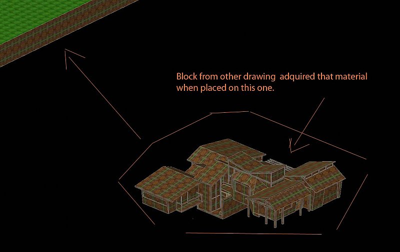

I added a block from one drawing to other, thing is the block (composed by different figures) changed its materials to one that is on the new drawing

You might be somehow right. Every time I create something in any layer it comes with the material. How do i remove it? I tried the "Remove materials from selected objects" and ......OH I JUST GOT IT !!! ..... DON'T MESS WITH GLOBAL!!!!

hehehe !! In the materials tab, there one called "GLOBAL". By mistake I altered it when creating a new material. Apparently, this global material relates to every surface drawn.
