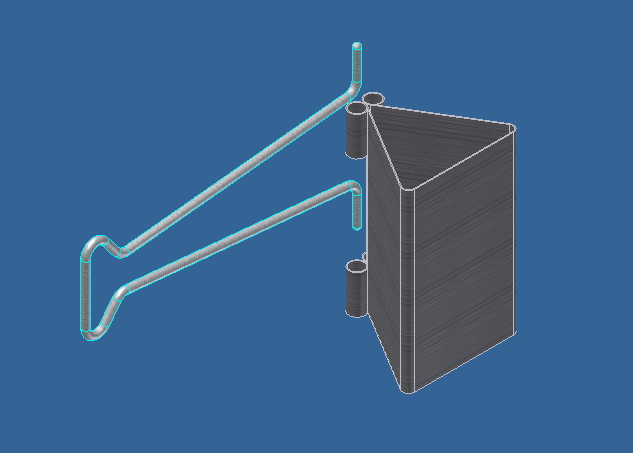

This is a picture of an assembly I have created, consisting of two parts - a wire handle (the lighter part) and a body (the darker part).
The axis of the two prongs of the handle are constrained (mate) to the axis of two of the holes on the body.
I need to adjust the height of the handle so that it is exactly central over the body. How do I do it?
When created the constraint, I tried to adjust the offset, but this didn't seem to have any relevance to this problem.
Thanks in anticipation :)
The second I posted this, I realised that I needed a further constraint which aligned the end of the prong with the top of the hole in the body. This would enable the offset to be used.
Sorry, it's getting late - I wasn't thinking straight :)
If you modeled the part with logical symmetry about the origin planes (Extrude Mid-plane) then simply add a Mate Flush constraint to the appropriate origin planes. This is the most robust method of assembly constraining.
