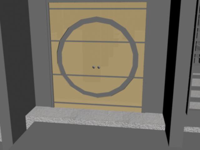

Hi all. does anyone have an idea on how to smooth out arcs in 3ds? in just only hit me recently coz ive just imported a model from autocad with a circle.
im working on trying out some of the modifiers to smooth it out but cant find one.
any help is greatly appreciated.
Thanks
When you Import the CAD model, you need to adjust the "Maximum Surface Deviation". I normally set this to 0.01.
Thanks Cad, i really got stumped on this one, i never checked the importation settings, my bad. hmm, i guess ill have to import the model again :D.
