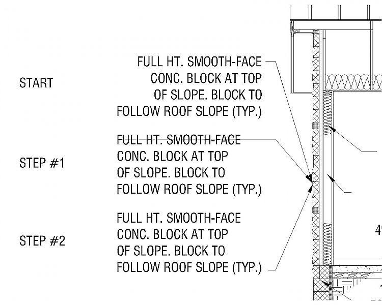

Need some help on this one. This is what was happened. We are doing a project that required us to mirror entire plan & sections (start - see pic), and it was not well thought out. Now all the text is justified right and the leader is in the upper right. ALL of my text must become justified left and the leader must be located in the correct location (top left / bottom right) I have tried to change all text properties to TL (step #1), but this makes the arrow tail in wrong location. I am tiring to get to step #2 automatically and use a code/lisp.
Does anyone have something that would help me? This is a large project and has happen to all of my text. This could take a long time to replace all leaders.

Are we talking QLeaders or MLeaders here?

Qleader w/ Mline Text.
